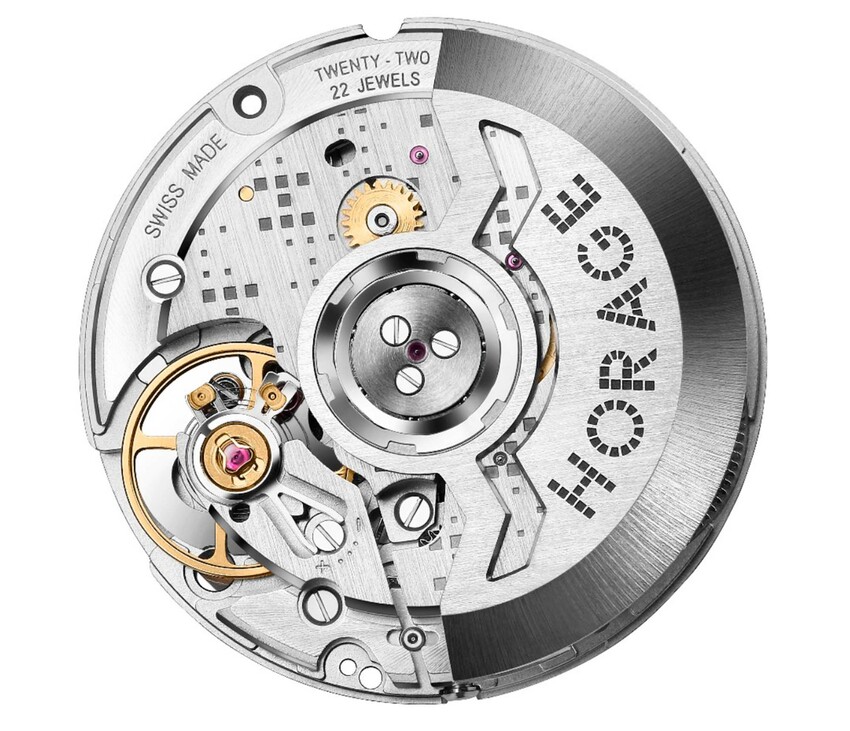

K2 Micro-rotor movement currently in production and consumer program starting Q2 2021.

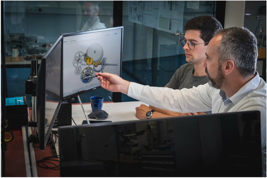

Horage co-founder Andreas Felsl going over the new drawings with Tourbillon 1 lead Silvan Deutschmann.

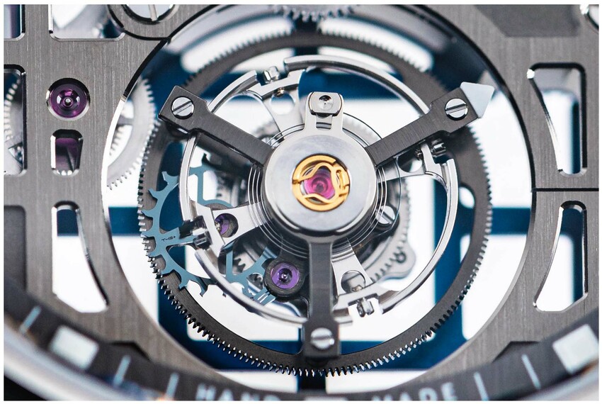

![](/uploads/default/wide@xs2x/D2yTIj-l.jpg)
The titanium flying tourbillon cage with 43 parts is packed into 3.9mm and weighs just 0.29 grams. Weight is a big contributor to precision and power reserve. If you look close you will find THE+ on the escape wheel.

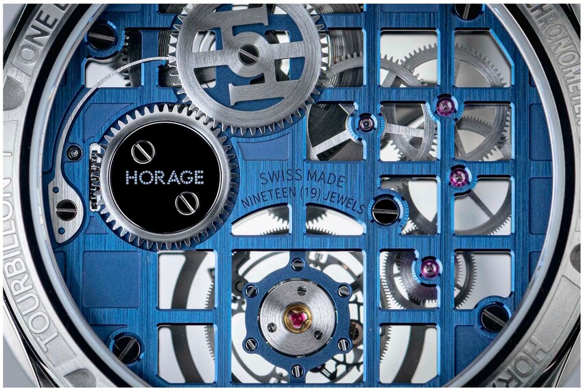

![](/uploads/default/wide@xs2x/Tq0UKoOZ.jpg)

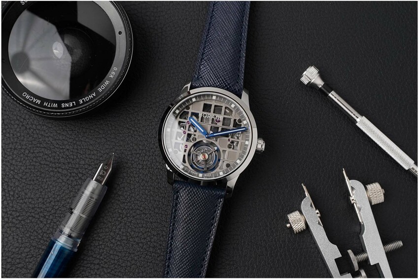

A mesmerizing case back view unlike anything else ever produced.

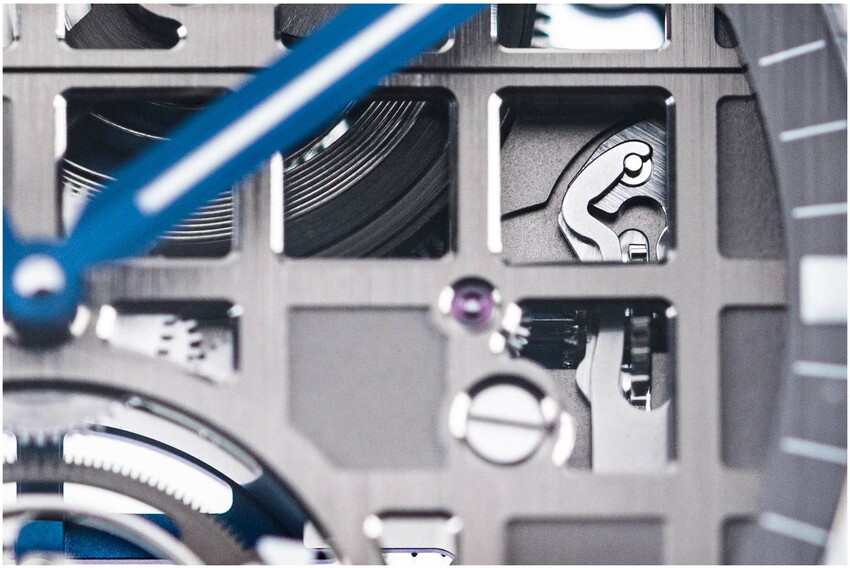

![](/uploads/default/wide@xs2x/7FKIfu2k.jpg)
The devil is in the details. Even the hands setting mechanism received a beautiful brushed decoration.
