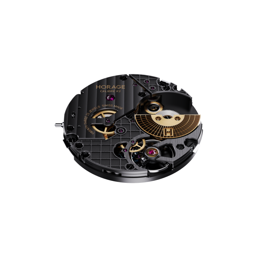

The K2 micro-rotor represents the next phase in movement development for us as a performance watchmaker. K2 leans on 12 years of modular engineering expertise that resulted in our core components tool kit which is essentially an inventory of heavily de-risked proven components that provide us with the ability to make new movements. The state-of-the-art engineering of the K2 rivals the best micro-rotor movements from top industry brands and features exceptional elements like a silicon escapement and a modular design.
K2 MICRO-ROTOR
Over 12 years of K1 development within HORAGE’s own Skunkworks in Biel/Bienne, Switzerland guided our watchmakers and engineers as K2 went from drawing board to living, beating prototypes.
The new micro-rotor calibre bridges the gap between low production manufacture movements and industrial scale workhorses, bringing the best of both worlds with cost-effective production merging with incredible accuracy and decoration standards. Like the K1, design and engineering are done solely at Horage's facility in Biel/Bienne Switzerland, as is final assembly starting at terminage zero. By controlling all of these aspects, we can offer a high-end Swiss Made micro-rotor with multiple complications at a price that simply cannot be touched. It’s an unprecedented accomplishment that reinforces the amazing talent and experience of our team.

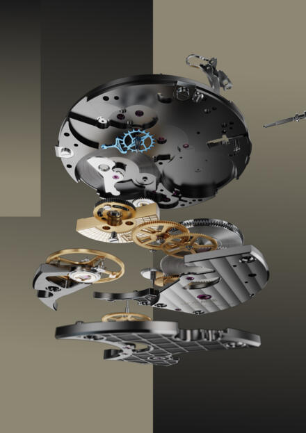

Modularity
The K2 is a modular movement with 38 possible variants via three different configurations – 2.9mm, 3.3mm and 3.6mm. The first watch to house the K2 is called Supersede and will come with the 3.6mm configuration. This allows for four integrated complications – power reserve indicator, date, central GMT hand and day/night indicator (with a standard three-hand time setup).
The flexibility of this design means that complications can be changed without altering the movement’s dimensions. At only 3.6mm for the movement, Supersede comes in at under 10mm in height (9.85mm), which is incredibly thin for such a loaded sports watch with a water resistance of 100 metres.

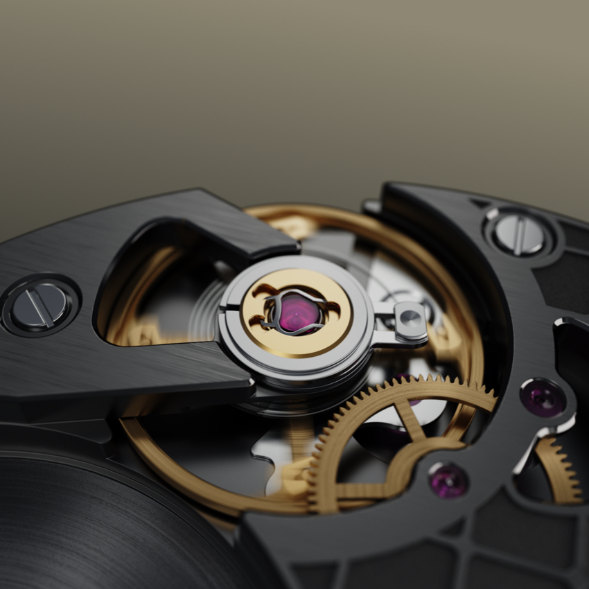

Silicon Hairspring and Escapement
All HORAGE movements, K1, K2 and K-TOU (tourbillon), have and always have had a silicon escapement that’s lighter and more efficient than steel, extremely corrosion resistant, anti-magnetic and virtually frictionless. The K2 calibre brings even more to the table, adding a silicon hairspring to the escapement wheel and palette fork. This is already rare and limited to a handful of major brands, and is likely a first for a small independent watchmaker like us.
What exactly is a hairspring?
There are two principal springs in a mechanical movement, the mainspring and hairspring. The mainspring is the power source for the movement, transferring energy to the balance wheel and escapement. The two transform this raw energy into precise beats per hour as the balance wheel oscillates back and forth, and the escape wheel and pallet fork transform that into controlled impulses – the tick-tock of a watch.
The coiling/uncoiling of the flat hairspring within the balance wheel is what controls the oscillations, and it must be flawless to keep the oscillations consistent and the movement accurate. The anti-magnetic, corrosion and temperature resistance of silicon make it an optimal material for hairsprings as external interference is minimized. Durability is also important as a hairspring will oscillate over 200 million times per year and our industrialized movements are designed to last a lifetime.

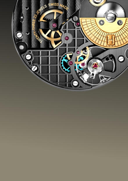

Finishing
As a performance movement that sits between manufacture and industrial counterparts, K2 sports impressive and unique decorations. It's finished with black gold plating and yellow gold lettering, Côtes de Genève on the main bridge, anglage edging and key cutouts that show deeper areas of the movement. The grid pattern is a signature design element and was inspired by the HORAGE logo. Decorations including Côtes de Genève, brushing and anglage are all hand finished. The micro-rotor itself is gold plated tungsten with laser etched tiles resembling the HORAGE logo, and has hand brushed and polished surfaces. Along with gold plated tungsten we also explore precious metal usage depending on the watch project. The movement has 23 jewels and many contrast well against the black background, providing a futuristic vibe.

- 2.9mm - Small Second or Centre Three Hands.
- 3.3mm - Small Second or Centre Three Hands and Calendar.
- 3.6mm - True GMT, 12/24 hour day/night Indicator, Power Reserve Indicator, Calendar and Small Seconds or Centre Three Hands.
