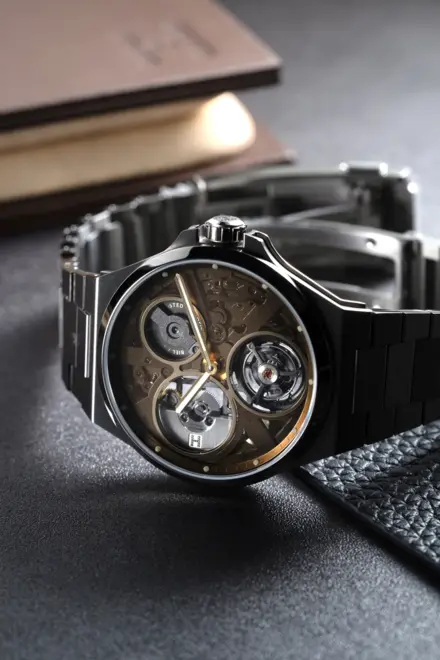

What we never previously told the community until now is that the watch we originally hoped to release back in 2023 is the Autark Tourbillon Bubbles. What appears to be a simple visual/design concept: turning the movement upside down—required four years of intensive engineering to become reality.
How did we get here and what did we learn along the way?
Firstly, as soon as we realised that this piece would take longer, our focus switched to delivering the Autark Tourbillon in the ‘conventional’ layout. ‘Bubbles’ as it became known within the company was developed and engineered in tandem but with an undefined, future release date.

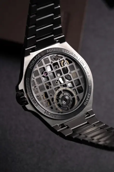

Secondly, when you flip one part over, a significant number of other elements must change too. A micro rotor at the front of the calibre rewinds the mainspring in the other direction! So, the ratchet and complete winding mechanism need to be adapted.
In a normal construction the 3 ‘core’ elements of micro rotor, tourbillon and mainspring are distributed over 2 different sides of the bridge plate. Fit them on one side and….well, no surprise they don’t fit! The diameter of the whole movement must be increased, which changes almost everything. In a normal movement key fastening locations are obscured by the dial: in ‘Bubbles’ they would be visible and therefore also needed to be relocated.

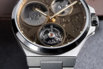

Like every watch brand we also depend on  specialist external suppliers. A good example for our ‘Bubbles’ baby is the translucent glass ‘dial’ made locally by GB Microfab. It supports the uninterrupted view to the K-TMR 2 calibre, which features open worked sections in and around the three ‘bubbles.’ The metal frame surrounding each bubble was a further manufacturing challenge. It is made using the LIGA galvanic growth process (eagle eyed readers will remember we also use LIGA tech to make certain geartrain parts).
The overall result is much more than just a different display. It is a completely new interpretation of how a watch is worn, shared and experienced. The three "bubbles" are not just design choices: they symbolize HORAGE's vision that the tourbillon is no longer merely a mechanism created to counteract gravity—it transcends it. Three interlinking windows, the flying tourbillon, mainspring barrel, and platinum micro-rotor float above the dial, creating an illusion of weightlessness.
